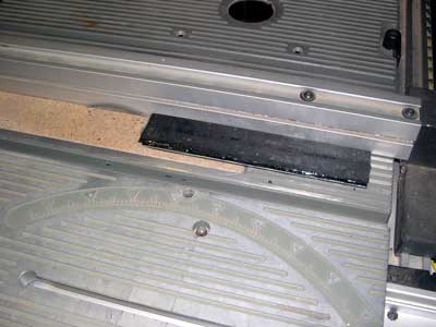

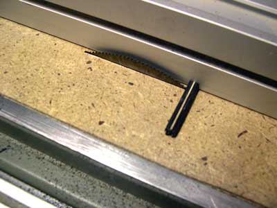

Posts: 993
I've made and cut many rosette logs and what works best for me is my table saw. I use the thin kerf blade from my fret-slotting jig with the blade stiffeners in place. I made a simple cover where the blade sticks up from the table so there is no room for the pieces to fall back inside where the blade is spinning. The best part is that the blade cuts so even and smooth that there is virtually no sanding required before gluing up the next log. If I do have to sand, I just run them under the drill press real quick. My veneer logs are about 2 inches wide when I start cutting, but it's still a good idea to use a push stick. With this small blade there's only a little sticking up above the table, but don't be tempted to do it by hand.
Good luck!

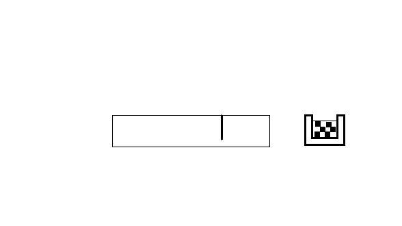

Posts: 413
Location: Toronto, Canada
First name: Michael
Last Name: Lloyd
I will build a small miter box to saw such small items. You can support the log with a shim along its length if necessary.
Something like this. It was harder to draw this picture than build the box.
Michael Lloyd
